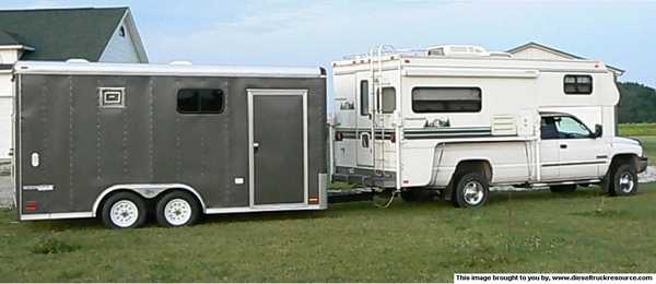

With some hefty rear shocks and swaybar to compliment your bags, your SRW should be fine towing your CJ with that camper.
Here is how I tow my CJ...11.5' slide in which is almost 5k wet.
Nice! That is what I'm shooting for next year. I just installed the airbags and will add the rear swaybar and camper next year. I tow a built TJ.
