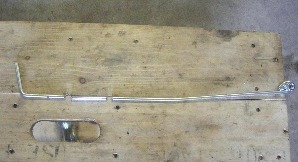

7) If you have wheel liners, you'll have to extend the latch handle. I added a piece of 1/4" bolt, 2.5" long to the handle. (Pic attached). Weld it in and grind smooth. This allowed me to just make a small hole in the wheel liner, about 3/8". The hole was located 5.75" behind and 1-1/8" behind and below the front liner bolt hole. When re-installing the liner, put the handle in first. Place the liner in and lay flat over the top of the tire. Pull out the handle and place through the hole. Hold the tip of the handle and rotate the liner up into place.
