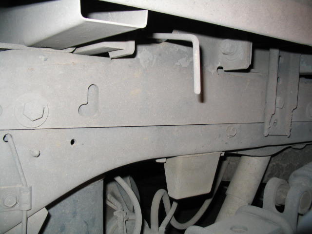

Here is a picture of the rod on mine and there is not a problem with the liner. If the rod turned down is a problem, I think it could be twisted to be in the clear. It would need to be twisted before installation to make sure the twist does not effect the latch end of the rod.
Daniel
