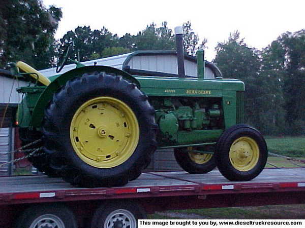

This one was 8000 pounds stripped down. Hauled it many a time on a wooden deck. Mine too is about six years old. About once every two years, I take the pressure washer to it, let it dry, and soak it with waterseal.

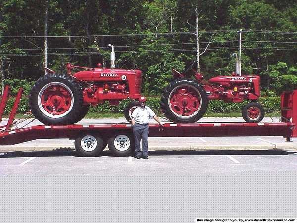

Hauled these two plenty of times.
Even hauled these two together with no problems. I will usually try to park the tires over a rail though.

It would be better if that FAT guy wasn't standing in the middle of the one picture.
