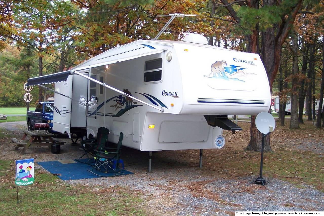

I'll never go back to a TT after towing a 5er (This is our second one). If you click on the above picture, it will show you the type of pinbox that is on our Cougar. All of the Cougars and most of the comparable size 5ers of today use these extended pin boxes from the factory. As the size and weight of the fiver increases, most manufacturers use less and less of an extension. So, if you are planning on a heavy (over 10k) and long (over 30'), you may want to make sure of the pin location on the trailer when using the short bed truck. I have never had any problems with the set up on my SB. My Dad is waiting on his new 05 SB to arrive and he has been towing a 5er identical to mine with his 00 long bed. He has decided to go with a slider type hitch just to be on the safe side. However, I have told him he will probably never use it, but since he wants to go from a two-way head to a four-way pivoting head, he might as well get the slider while he's at it.
