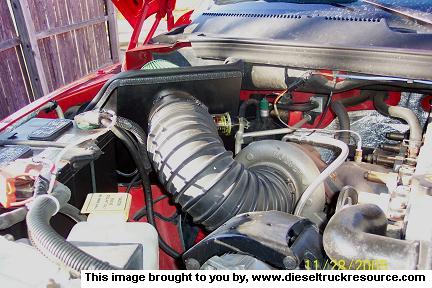

I got the box on. I'll post the pics when they're approved.
Old Nov 28, 2005 | 10:04 AM
  #43
crobtex's Avatar
Joined: Oct 2002
Posts: 4,983
From: Sedalia, Texas
The box looks good.
I haven't driven it but about 200 miles on the hwy since the install, but the throttle response seems to be better, and the EGT's cruising at 65 mph are about the same. I haven't towed with it yet.
