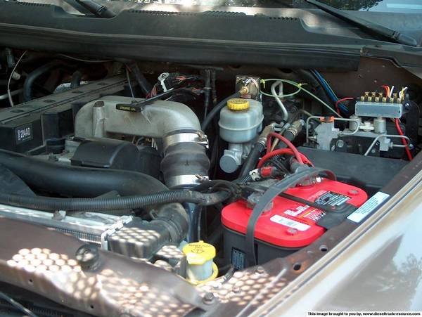

I think I have pic in my gallery, but just mount a fuse panel from delcity.net under the hood. The fuse panel has a 8ga feed and 6 fused circuit. All my acc are ran off of it. 2 12V outlets by the back seat, an extra 12V in the bed and my topper light, reverse lights and 2 lights under the truck. I mounted 2 of them under the hood.
Forgot about posting pix. U can see them in the upper right corner. There are more wires on them now.
