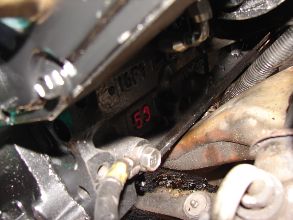

It is actually on both sides of the block.
Driver side
I don't seem to have a picture of the passener side though. I remember painting it red as well though.
