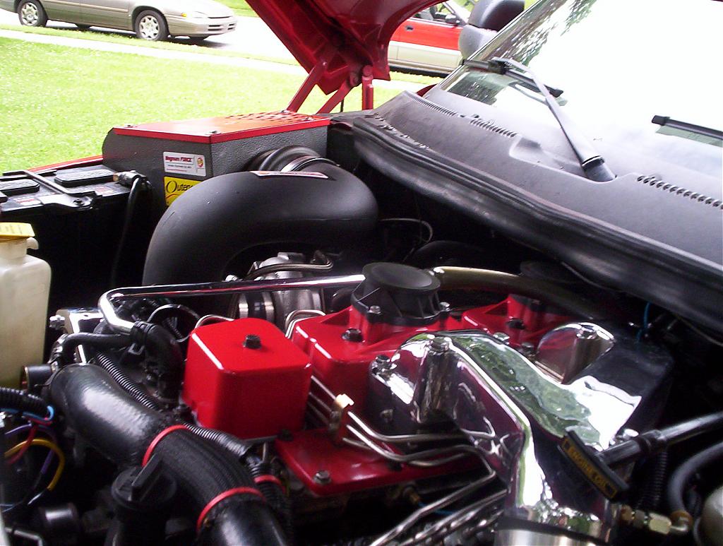

Here you go answered in order for you about my 98 12v.......
My truck is used as a daily driver,never is parked inside a garage and is used no matter what the weather conditions are.The only thing it hauls is my extra large frame or something in a box that will fit in the bed.It is not used to haul anything else and rarely used as a truck would normally be used.Sled Puller...never,that means dirt..Drag Racer...never,goes to slow and will not wheelstand ever.It may take me to events like that but I am the one who would cover it to keep it shiney to go home,LOL.
Many internally on the motor and each one makes it all the better.Most all of them motorwise have been done at Enterprise Engine.They also installed the turbo and its a Garrett GT37R Stage 3 which is fed fresh air through a AFE Stage 2 intake using a Mega-Cannon filter.Its low end spoolup will sit you in the seat and is one of the nicest street chargers around.Its a roller ball charger,with a water and oil cooled center section.Its a great under rated charger for those in the under 500hp group.I can get mine to there,500hp,but it will not cross that plane for some reason.I would put it up against any of the small chargers out there and would bet money on it killing them in a low end spoolup contest.
The one thing that EEP did not do was the fuel system.I had a local shop,which wants to remain nameless, do that for me.A new P-Pump was done with 500cc of fuel and a custom set of 5x18 injectors installed.I run one of their plates and can run the rpms into orbit also.I know its not needed as most 12v's go into valve float way before that and after 2700 on a dyno they are dropping power faster than falling rocks fall.
On the most recent dyno test after installing the electric fan setup it did 494hp and 1186tq with the Garrett Stage 3 feeding it.Its driven like that everyday and I make zero changes to it other than changing the oil.Its a blast to drive and still can get 20mpg on the road when you drive sensible.
it will haze slightly on a hot and humid day otherwise its not bad at all.Now,when one steps hard on the loud pedal and the rpms begin to fly,its time to let the coal roll.I have a friend who was behind me once that said,"Dude,don't do that you know how hard it is to follow you when your rollin coal".The Garrett will spool up with little or no lag and plant you firmly in the seat which would make you think you are driving a stout running 6Barrel Cuda.
Hope that helps some and here is a shot of my motor with the Garrett on it.....Andy

Hammer,
That is a nice setup you have there, wish I could afford to run the same setup myself. I disagree with you about the Garrett Turbo though, I don't think anyone here underestimates it, we just need more air for less money, and companies like HTT, II and others can accomplish that for us. Someday many of them will switch to Ball Bearing center sections as well, but for now, cost is the reason very few run that charger.

) It's a 62mm and a .7A/R housing, or 11.77cm IIRC!Personally, I'm sold on the Garrett's Dual BB cartridge. My buddy runs a Stage II that I found him for $1000, and it cools 400hp perfectly, and I gave about $1400 for my GT4088R which is a bigger charger than Hammer's GT3788R, all the difference being on the turbine side! It doesn't spool as good, but I think that I have other problems on that aspect...as far as cooling, I've only dynoed 380hp so far, and it barely touches 1300* at that level...I have a lot more left!
