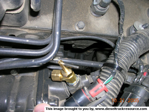

A picture of mine, went to Lowes and found one in the pipe/brass fittings area.
On the dyno, it ran 290hp valet on, no valet it ran 432, load dyno.
