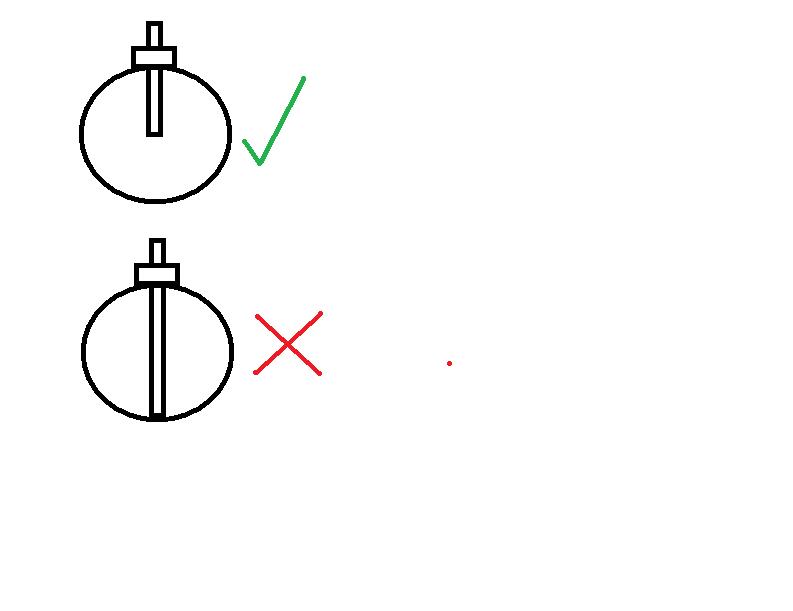

Make sure when you position the probe in the exhaust runner, that it it not hitting the bottom of the runner but the tip should only extend into the middle of the exhaust stream
