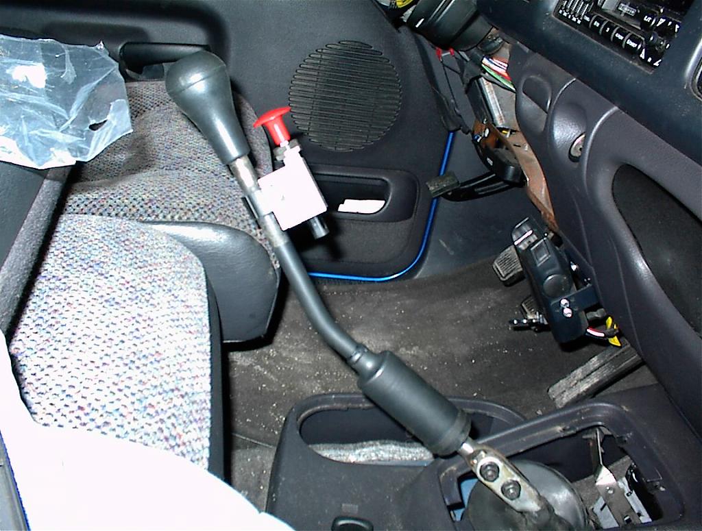

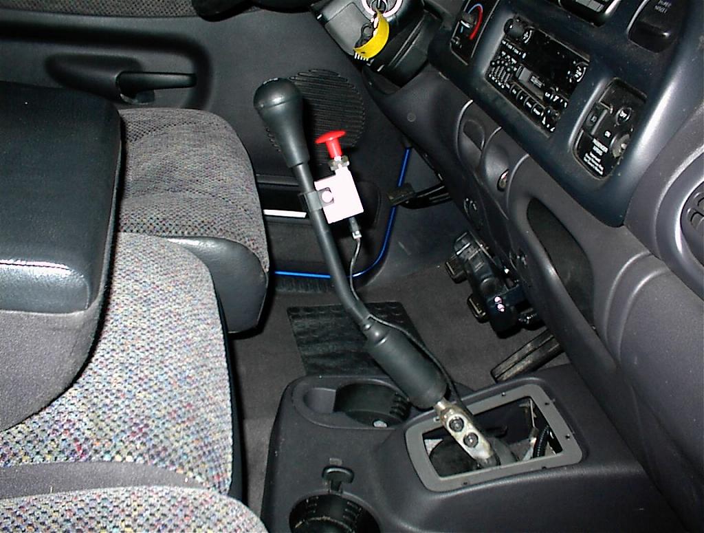

hears a switch I got at napa 20.00 and the wire connector is used in gm cars I also installed this switch on the dash to activate the circuit this is on a 98 with a 06 brake and g56 6 speed twin turbos.
Attached Thumbnails Tips on installing exhaust brake-truck-rebuild-074.jpg   Tips on installing exhaust brake-truck-rebuild-135.jpg

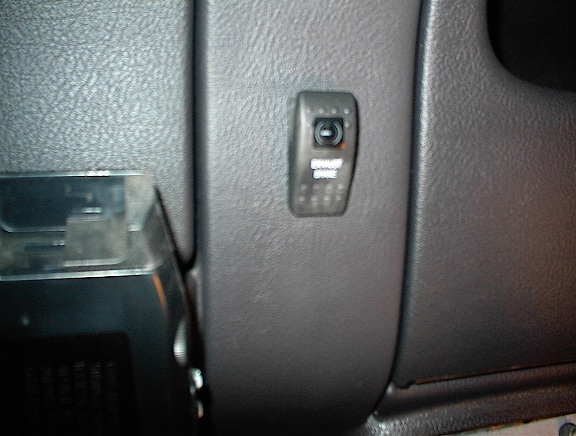

finished product
this switch is like a two speed but has its own mounting and use a simple two connector. I still need a boot.
