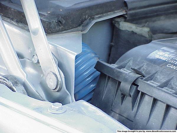

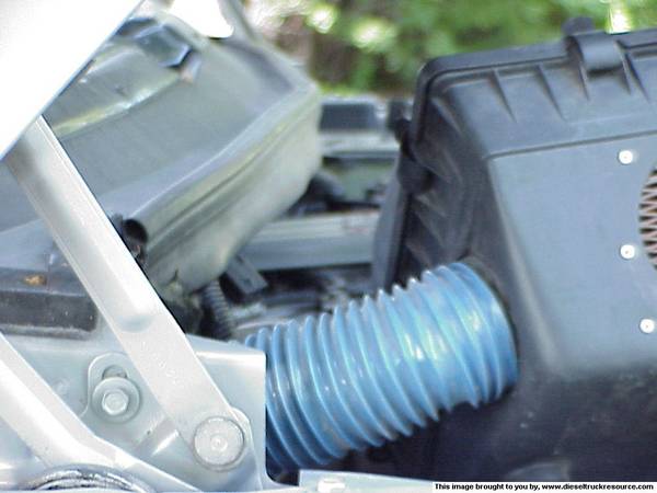

Holesaw a hole in your firewall and another in bottom passenger side of the airbox. Connect them together with 3" RV dump or clothes dryer hose. No clamps or sealing needed, leave the stock fender opening open. Air will be forced into the filter from the vent intake when the truck is moving.
Poor man's Scotty that works almost as well.
Where does that hosing go? Is there anyway to have it come into the other side, and have it run down towards the front of the bumper? Just thinking of all sorts of different ideas

He took a hole saw to the cowl. I tried this after the air dam and saw no difference in egt or spool and now have a 4" hole in my cowl
