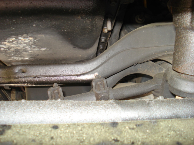

I was just going to make a post about a track bar. You and I have the same year and model. I have installed the DSS and my drag link adjustment bolts are rubbing on the cross member.
How big of a job is replacing the track bar? and will the truck require an alignment afterwards.

Loosen the two bolts on the drag link adjuster and turn the two sleeves and bolts so they are facing the ground, torque them up and your done no more rubbing. As for the track bar I have not changed mine out yet but it does not look to bad.
