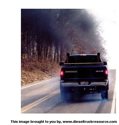

I split mine in the bed and y pipe is offset to the passenger side along the natural exhaust line. The only time I saw uneven smoke is when I had a y pipe with out a divider plate in the center. With the divider plate its nice and even. Couple more pics in member photos. I say do the stacks!!!! If you dont want to cut a hole in your rig, maybe straight pipe, either way it sounds good.
Here you see nice even smoke

From: Southeast,MO
Good pics
