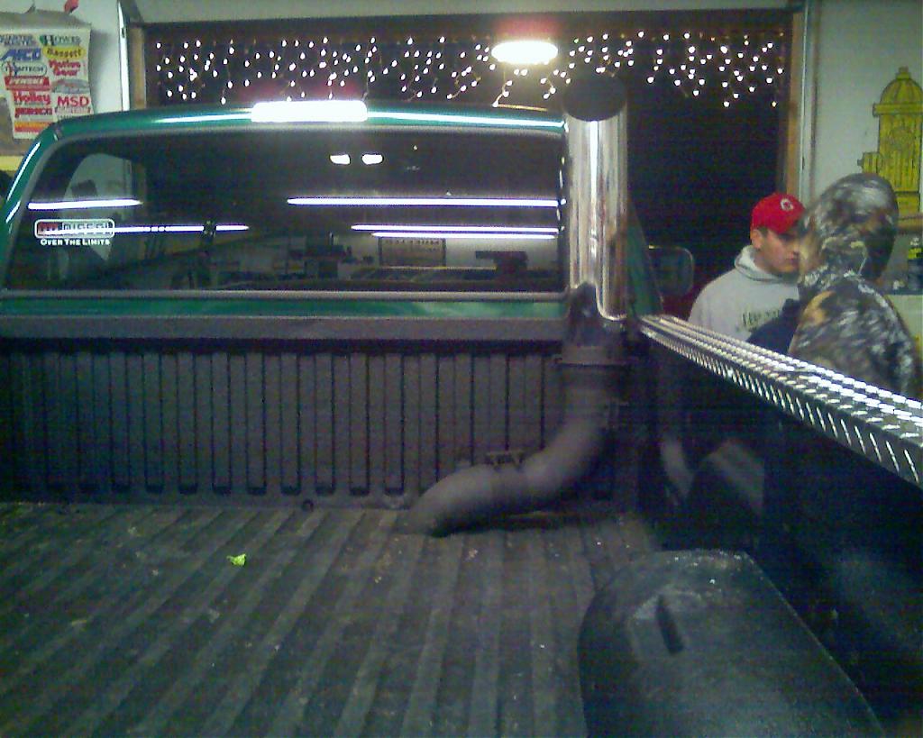

you will need 3 90s to bring it out in the corner
i hope the picture helps its a 6 in single stack on a 94

o yea the the 3rd 90 is under the bed pointing up
