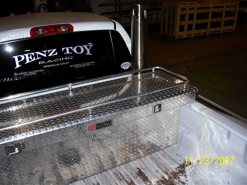

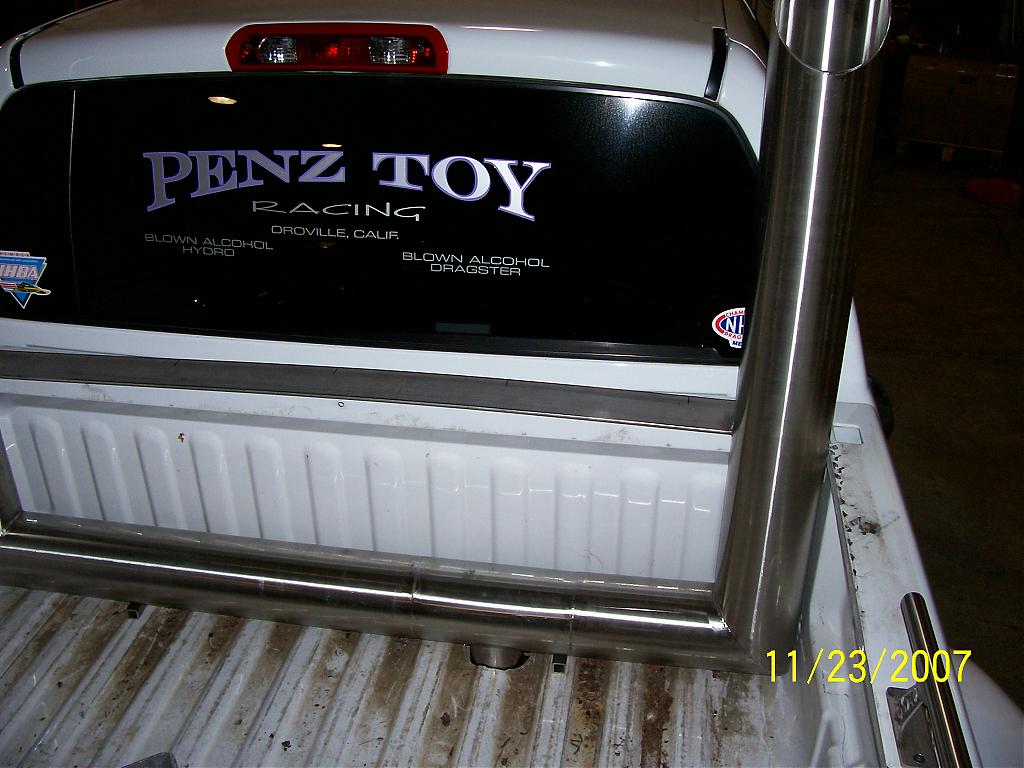

build your own
Get a 6" piece of Polished Stainless for a couple hundred bucks and build your own set.
Attached Thumbnails Looking for cheaper stack kits-101_0823.jpg   Looking for cheaper stack kits-101_0833.jpg
Old Dec 19, 2007 | 02:09 PM
prattman's Avatar
Posts: 300
Wow!!! Nice work on the stacks. Awsome.
