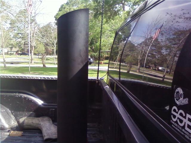

ok wat i did was i went to my big rig store and paid ten bucks for three feet of 5" flex pipe. i had a 5" 90* off a generator. then my bud had a 5-6" stack. i cut a hole in my bed with a 4" ko cutter then made it larger with a grinder. i painted my mitre cut stack with flat black header paint. for the rain i have to put a coffee can over it. i had to cut some slits in it for it to fit over my stack but they do make stack caps. this pic was before i added my extension pipe to make it stick above the cab.
