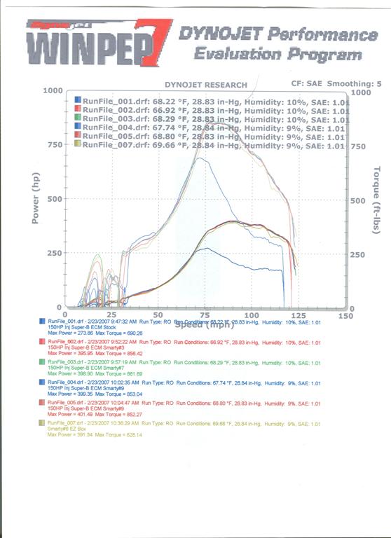

I did the Smarty and DDP 4 's the other day. But I also upgraded to a Super B turbo from the HX35.
Like yourself, I am skittish about tapping the pump wire. My goal was for 400 hp without molesting the pump wire and I got it. This was on straight #1 fuel.
I'm really liking the #7 setting so far on the Smarty. Roads have been too bad to try the Smarty on Kung Fu.
Trucks manners are very good just going down the road. Get into it, well thats different.
The truck dyno'd 273 with the sticks and charger with the ECm on the stock setting.
The Smarty REALLY brings the injectors alive.
I think you will really like the Mach4's alot..
Here's the sheet from the other day. Good luck with your decisions....

When you ran it without the Smarty, did you feel it defuel at all? When I dynoed my truck without the Smarty, it still felt real strong, would boost to 35 psi and not quit. Dynoed 300 even without it. Adding the Smarty picked up another 76, didn't see anymore boost out of it.

128 diffeerence from the smarty is outstanding. Now that dyno did have a positive correction factor, but you're running #1 so you could see better numbers from #2 in the spring.
I'm begining to think a smarty makes more power with a 6 speed after some of the positive results like this people have been posting

I'm not sure how to answer you on that on. The only time the trucks run this combo with the ecm stock was for that one run. Thats it. The dyno operator made now mention about the boost or defueling. I only did it out of a curiosity.
The next run was smarty #3 and that went 395. His response was holy poop.
I completey skipped #5 because I had ran that the day before and didnt like it. Truck surged on cruise control so I skipped it.
The rest of the results were 398 to 401 and tq from 852-861.
All I could squeeze for boost out of the Super B is 33-34 lbs. Thats it. Even clamped the wg off. No mas. Kinda surprised me a little.
Truck spools like yesterday tho and the tires start skipping at 25lbs boost.
Phatty, not sure what you mean about the positive correction factor. Not too well versed in those areas. Good or bad?
