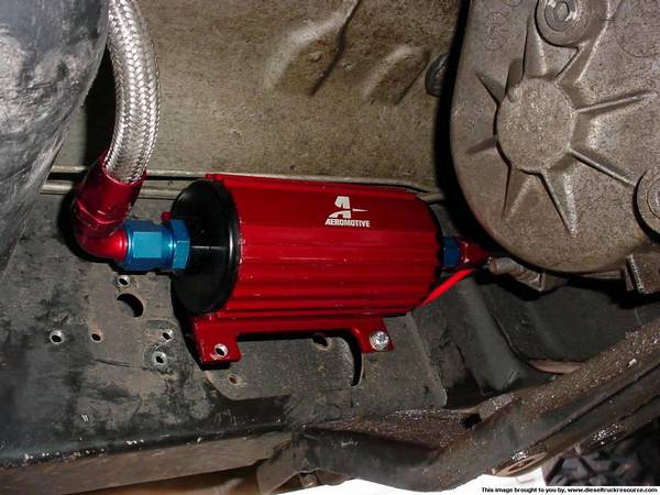

Im in the market for another pump too. I copyed this from Saxet Nomads photo Gallery
Maybe he or someone can fill us id...

Yeah I looked at that exact one also. A1000 Aeromotive, flows 500 lbs/hr at 45psi. I just can't drop 300 bucks on a pump.

I saw the price too. Dont need 45 psi anyway , then you will need a regulator and return line.
