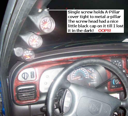

What does the bolt attach too? Does it go into the old snap in fitting for the old "A" pillar cover? Thanks

No, you don't use the old snap fitting. I just put the new pillar cover in place where I wanted it, making sure the bottom was in it's place. Then I eye-balled where I wanted to put the screw. Then I pulled the top of the cover down to make sure that where I was going to drill the hole,,,, I would be drilling into a good spot on the metal a-pillar frame. After a few rechecks to make sure that I would be hitting a good spot in the metal a-pillar, I held the cover in place where I wanted it and drilled a hole straight through the cover and into the metal a-pillar. I then used a self-tapping screw to hold the cover tight. Some folks have even taken a piece of metal tubing and cut it to slide over the screw on the back side of the cover to act as a spacer, but I didn't see the need for that. Like I said, mine has been up for over two years and is still as tight as when I installed it. I've even taken it down to do some other wiring work and put it back up with no problems.

Screw location
