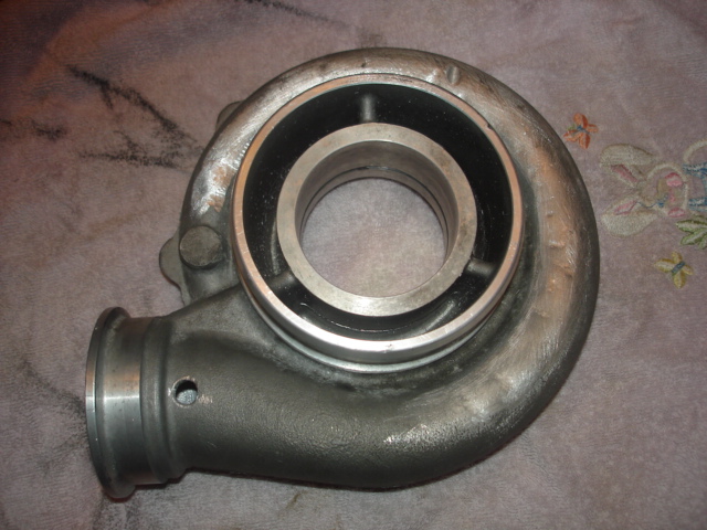

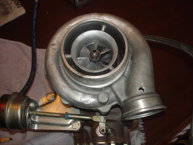

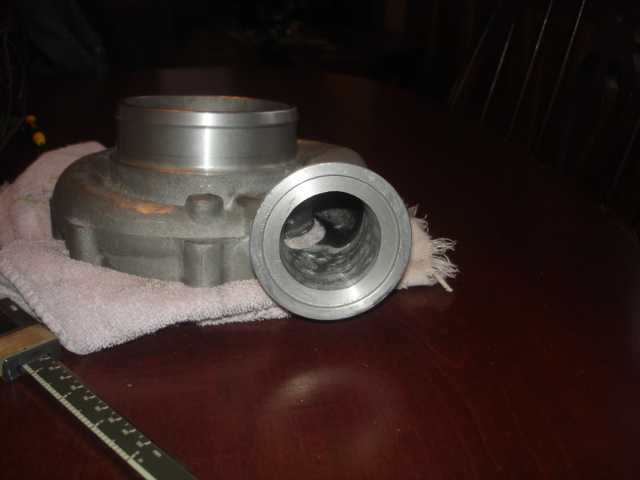

First thing I did was open up the compressor discharge (first photo). When I measured mine I initially had 2.00 in^2 of area at the exit. Some Minor grindage put me to 2.54in^2. About a 26% increase. With this, the limiting orifice is now at the tips of the compressor wheel which has an effective area of 2.20 in^2. What this means is that out of the factory the limiting orifice on the turbo was the housing discharge. I then went to the inlet and flared the casting to smooth the air flow entering the turbo. (photo 2 is before photo 3 is after.) I left the rest of it alone, not wanting to screw anything up. I could have ground more on the discharge end but I didn't want to make it too thin and since it was no longer the limiting orifice there wasn't much I feel could be gained. (Besides, my compressor bit the dust)

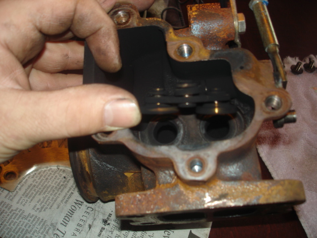

Now that the Compressor was done and ready for polish, I turned my attention (or lack of) to the hot end. Since the turbo set builds boost very well, I felt that to get it to flow better at higher power levels and rpms I should start at the waste gate.

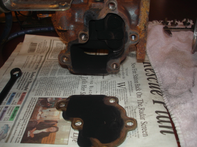

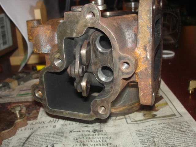

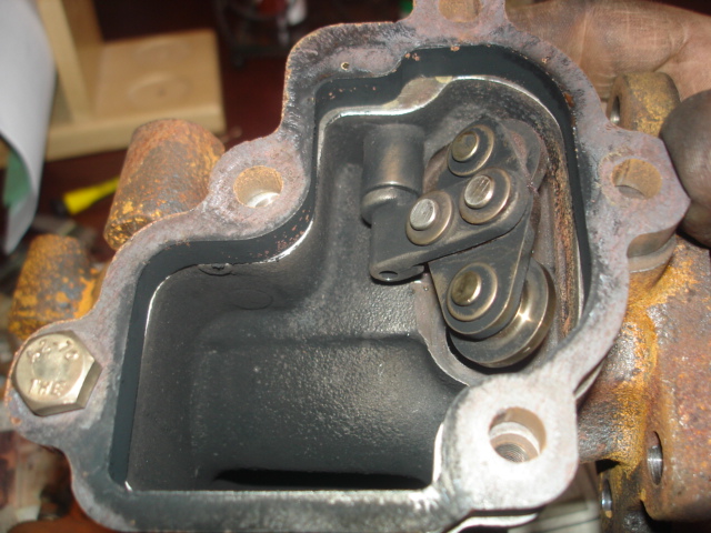

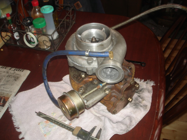

Upon opening up the wastegate housing, I found that the gate is quite restricted in its movement. The cover plate limited the travel to 0.1 inches, which when you calculate the open area was almost equal to the size of the ports. (photo 1 shows this, if you look at the plate you can see where it was hitting it). So I went to pile of old turbos and found an extention plate which gives the chanber more volume, and alows for more travel of the wastegate flappers. (photo 2). To get a better idea of how much this will allow it to open it took photo 3. In this position it makes contact with the cover plate. I also ported out the wastegate ports approximately 0.10" each. This still provided enough seat area to insure that it closes. (i'll put that photo in the next post since I can only do three each)

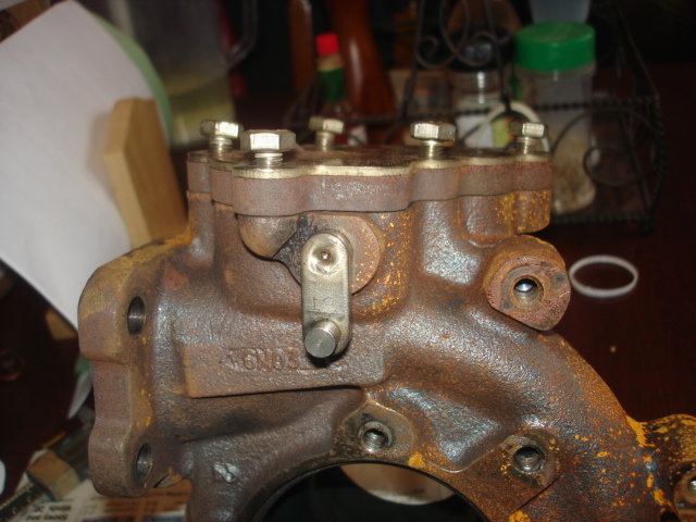

Photo 1 are the ports before grinding
Photo 2 are the ports after grinding
Photo 3 assembled turbo
I never thought of opening up the ports though! How much minimum wastegate flapper overlap is required to still maintain a good seal against drive pressure?
I think the key is making sure there are no burrs. I left about 0.12 overlap and made sure they cwere flat.
I expect with the increased surface area, the gate will open sooner, I am hoping around 40psi boost. I can always set it higher if needed.

Good mods! I would hope that the compressor discharge mod was tapered, like a nozzle would be shaped (think Space Shuttle rocket discharge). That will give you minimum turbulence.

The compressor outlet size is relevant to the parallel diffuser hight and diameter; in the case of the Super B the PD is small so the outlet size is smaller than usual but doesn’t cause back pressure.
The parallel diffuser is the round flat area between the comp wheel and the compressor scroll; it starts the slowing down of air velocity that will eventually be converted to static pressure. this turbo is designed for high pressure aplications and has very good high pressure surge protection, opening up the compressor outlet would reduce compressor outlet velocity and could effect surge and cause off throttle surge or pressure back up.
As for the wastegate opening more this will increase negative delta pressure (exhaust pressure higher than compressor) you should try closing in the wastegate or shutting it off; when you open the wastegate the lower turbo speeds up so the overall pressure may not drop. You may have to reduce fuel slightly until you O-ring the heads.
During testing we controlled any negative Delta P by closing in the wastegate, the results were at 60lbs the pressures were even; and at 70lbs the exhaust was 5lbs higher this is very good.
You must remember the purpose of the wastegate is to control boost pressure not to lower exhaust pressure.
