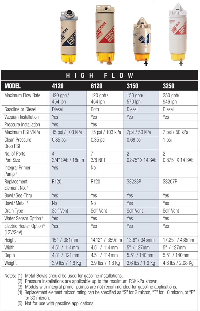

This is what I will be using.
http://xj.cdevco.net/auto/fuelsystem...N-HIGHFLOW.JPG
#2 on that list. Cost is about $150. Combine that with a gravity fed fuel system (drill hole in tank and mount a bulkhead fitting - $10), a cheap Carter fuel pump ($90) mounted on the frame rail *AFTER* the filter and 3/8" Goodyear "fuel injection" hose ($50 or so) and some anodized fittings replacing the banjos ($40). Another $50 for some 12-14ga wire, a relay, some barbed 3/8" NPT fittings, etc. Total cost is around $400.
