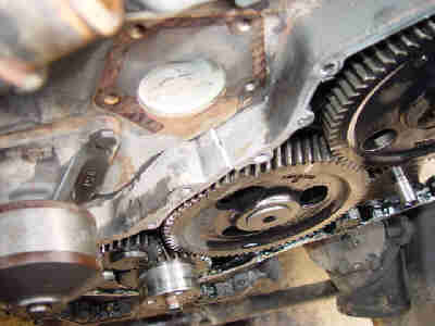

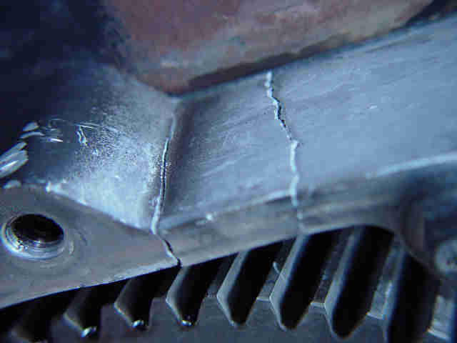

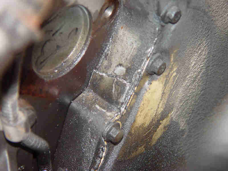

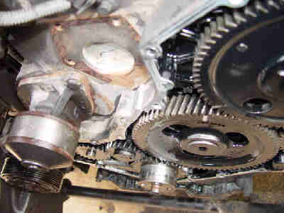

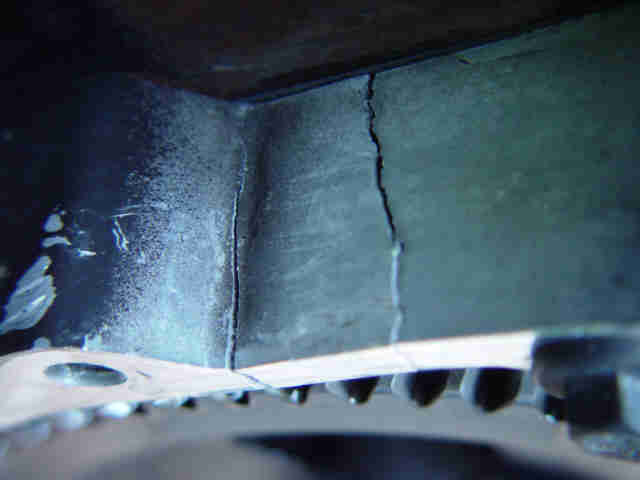

BTW, you do wanna take care of that KDP. The pictures on that website were taken of my truck after the pin fell out. That was not a good day. >
Here's a couple of more pictures
http://hotroddiesels.20megsfree.com/images/KDP1.jpg
http://hotroddiesels.20megsfree.com/images/KDP2.jpg
http://hotroddiesels.20megsfree.com/images/KDP3.jpg
http://hotroddiesels.20megsfree.com/images/KDP4.jpg
http://hotroddiesels.20megsfree.com/images/KDP5.jpg
