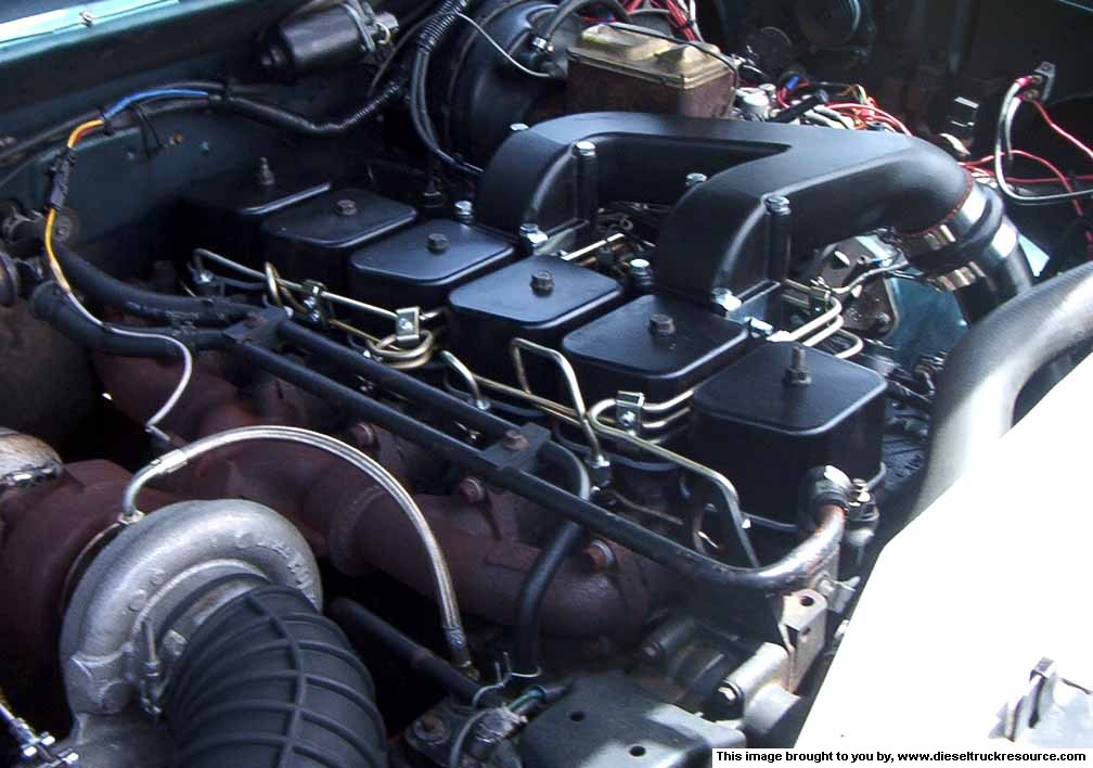

Thumbs up AFE air horn
Check this site out!
Bob did a dyno run posted it here also has some pics of the new AFE air horn.
Looks like it works will
http://www.southcoastphotographic.co...opic.php?t=415
David

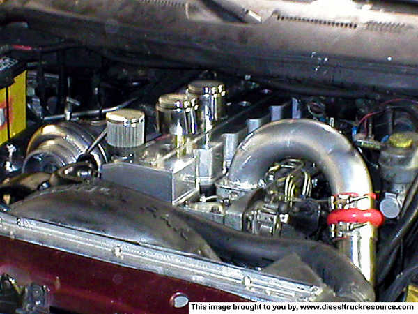

For the DIY person all you need is 2 90deg 3in pipe being mild steel, stainless or aluminum and a 3/8 plate and you have a nice intake weather b for looks or mayb a HP gain who knows , I made my own from scrap at work I also removed my grid spacer and made a 1in spacer out of pholenic (witch is used for cooling) and cut me some tornado grooves in the sides I dunno about any gain or what not but man this thing keeps the intake cool , now if you let it set after a run for say 5 minutes then it gets hot from the heat soak from the head but after a run its just as cool as outside air if not cooler , I think I'll b making a intake plate cause that thing is very hot so its getting my lines hotter to , we'll see how it does , I got some pics I uploaded of my intake but i never took any of the spacer , Hellman has a nice Intake to still I couldnt see spending the $$$ when I saw the parts laying in front of me
Old Jul 3, 2007 | 05:48 PM
Teddy Bear's Avatar
Posts: 599
From: Lancaster, Ky
There ya go Rodney, i posted a pic for ya. Rods intake looks really nice and i dont really see how the other aftermarket intakes could be much better.
