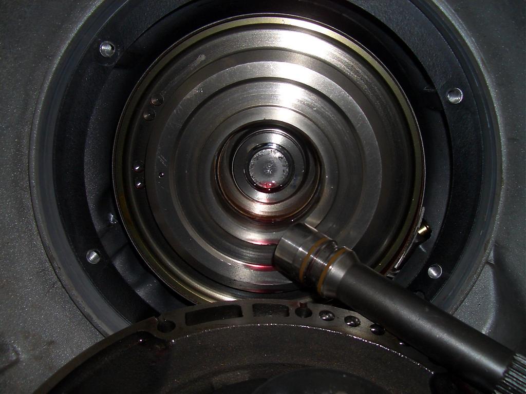

well the bad news is that it was the input shaft.

That sucks! Is anything else torn up?

no not that i can see. i just took the pump off and pulled the shaft.

You got lucky on that one bud. That could have easily taken out the entire front part of the tranny.

ya i know. i am real lucky. now will the output shaft go out too you think or no.
