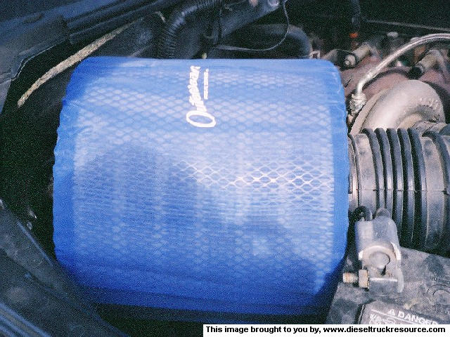

graphitecumnz's Avatar
Joined: Mar 2004
Posts: 1,385
From: Wichita, Kansas
hooks right to the stock intake tube and it looks like this(sans the Outerwears)

Old Jan 25, 2006 | 08:27 PM
mxdsl183's Avatar
Posts: 86
where do you get those covers like that ib your BHAF, are they water proof?
Old Jan 25, 2006 | 08:31 PM
phox_mulder's Avatar
Posts: 6,522
From: Sandy, Utah
Not water proof, but quite water resistant.
http://www.outerwearsracing.com/prod...22392E43D83493
If link doesn't work, click on "search by make and model", then put BHAF into the keyword box.
phox
Old Jan 25, 2006 | 08:32 PM
Dr. Evil's Avatar
Joined: Jul 2003
Posts: 7,129
From: The Great White North
The link is already posted above.
