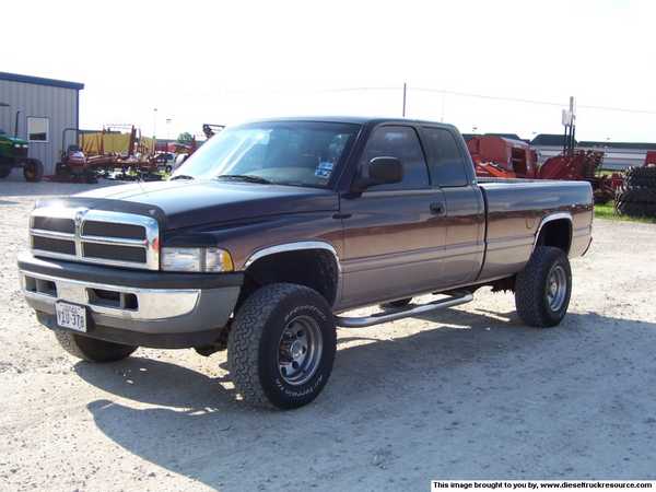

First, truck when I bought it...minus the goofy bed rails and junk toolbox! Also debadged!

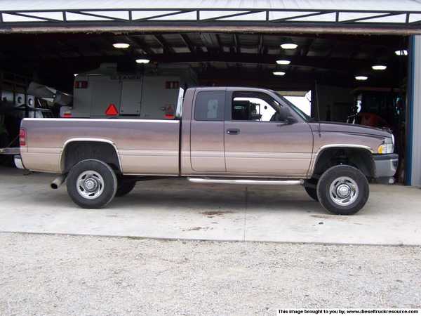

Next...2" Coils from CSS, Bilstein 5100's, ThurenFab Trackbar and Crossover Steering!!!!

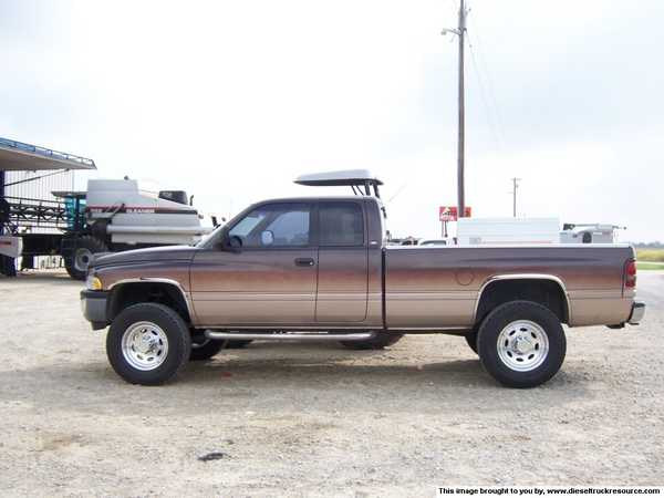

Finally...
Rollin' on the new rubber after a 2 month wait.
Vision Type 81 Forged Aluminum 7.5"x19.5" Wheels
Yokohama RY303 285/70R19.5 Load Range H Tires @ 100psi...need to go to 120psi...have a little swaying!

I still like how it looks in the first pic but the third pic is definately mean looking. Best looking set of 19.5's I've ever seen.
On another note, how are you liking that crossover steering? I'm debating doing that as well.

after another look I think you need an add-a-leaf, or some bags in the back, looks like it's saggin a bit, need to get her back standin tall in the rear!!! LOL still looks awesome though, Dusty
Thanks...I personally hate tires that stick out that far...but that's just me. The widest I'll ever go is a 285...which is perfect for my tastes!
Crossover steering...Love it. Easy to install, other than drilling the pitman arm. Easily serviced, and tough! I like the fact that I can rebuild it completly, not have to replace EVERYTHING...just the rod ends!
Yep, the more I look at it, the more it sags Have Factory overloads, and 1-1/2" blocks to go back there for now...not sure what I'll do permanently, yet. I'm thinking Air

Old Sep 16, 2006 | 10:28 AM
TxDiesel007's Avatar
Joined: Dec 2004
Posts: 3,411
From: Laredo
Awesome lookin truck chris!
how tall are those tires? and what a way to fill the wheel wells..

35"

If I did my math correctly, it comes out to 15.56% difference between a 245/75/16 and a 285/70/19.5. Personally, I like how it looked before. I like a taller sidewall on 4x4 trucks, and for the tires to stick out a little. Not 3-4'', but just a little. Those are the best looking 19.5's I have seen though.

GPS is telling me 18%...at 59mph, the speedo shows 50mph. 59/50=1.18, or 18%
I like a proportional tire..not a little tiny wheel and 40" tires...I also needed plenty of weight capacity in case I ever have to pull something...farm equipment can be heavy! Not too mention I've never seen another one set up like this...the rest of the truck is different, might as well make it a package
