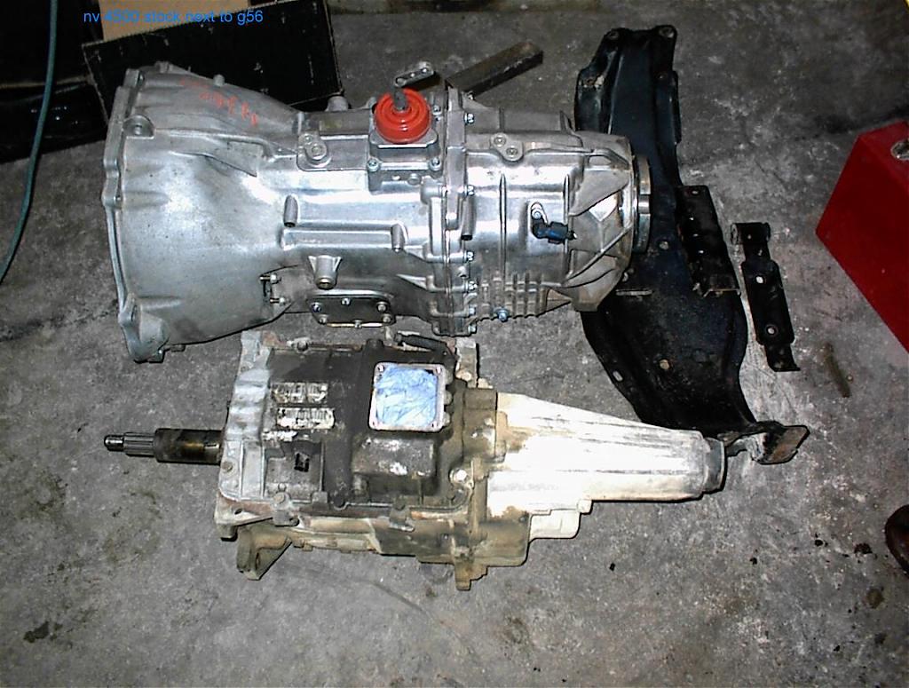

I just did this on a 2wd and I don't think it would be much harder on a 4wd. DD clutches are available I have 3:54 gears and the gearing works out to 150 rpm more in 6th I haven't drove it yet do to all the up grades I have done and now I'm building a dual filter air box and waiting for some elbows.the truck should be done this week.

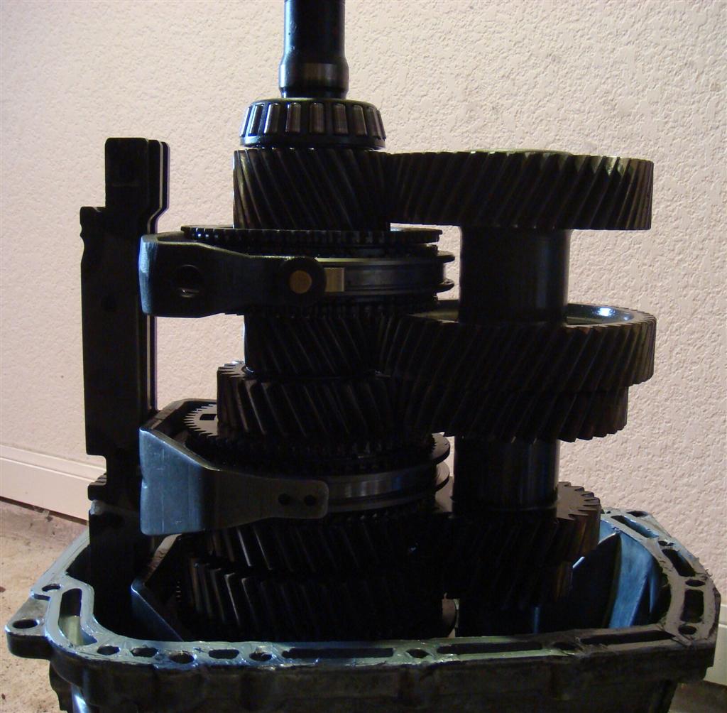

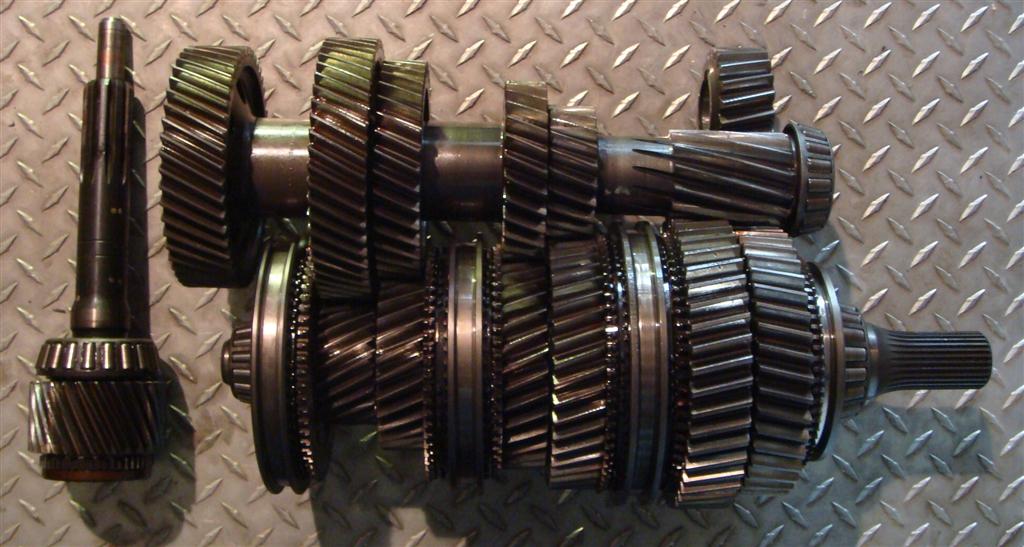

I had another one apart in the shop last week:
What would you like to know?

Besides, I've found the G56 to be quite beefy & well-engineered on the inside:
... even if not always very well manufactured.

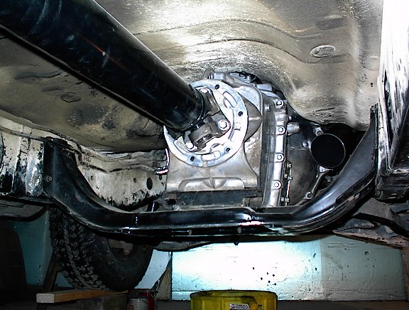

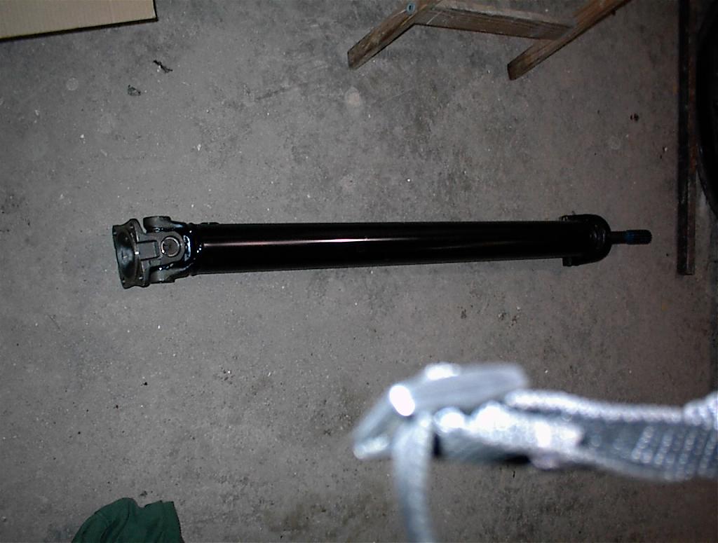

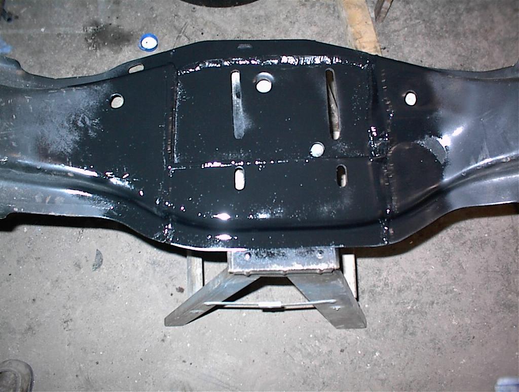

This is how I did the cross member and the drive shaft is 3.5 inches longer on the front half of two piece. but measure any way I all so used the stock rear rubber mount. Ill post a pic tonight under the truck.
Attached Thumbnails I want a 6 speed, but which one?-dsc00008.jpg   I want a 6 speed, but which one?-dsc00003.jpg

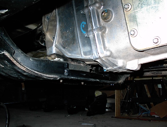

g56 swap
hears the g56 installed
Attached Thumbnails I want a 6 speed, but which one?-truck-rebuild-127.jpg   I want a 6 speed, but which one?-truck-rebuild-125.jpg
