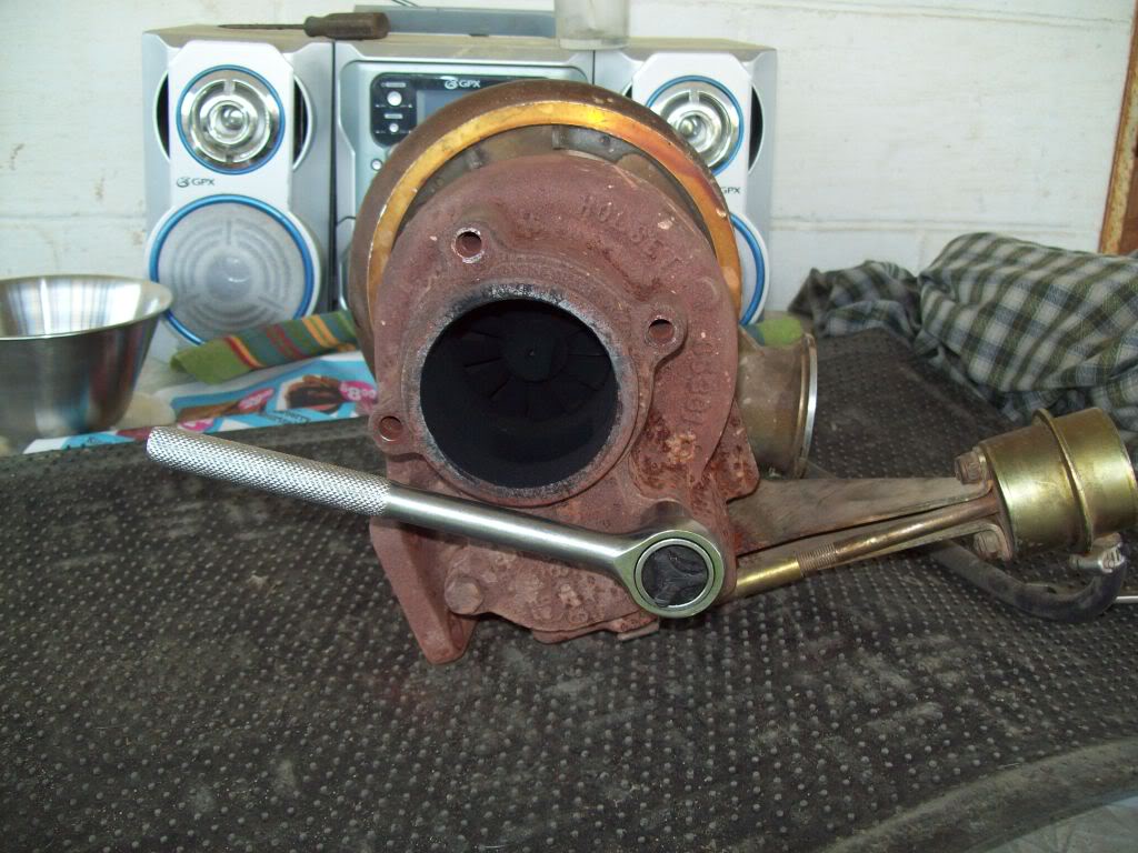

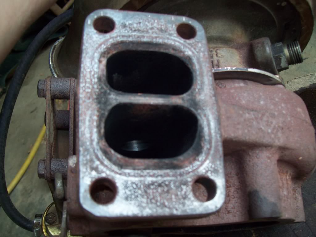

Im trying to get as much use out of my hx35 as i can so i tried the wastegate mod. so far i can tell that it does help keep the EGT's from climbing so fast. I was able to do the whole mod in about one hour.
once the turbo is off the truck first take the plate of the side that cover the wastegate using a 1/2 wrench

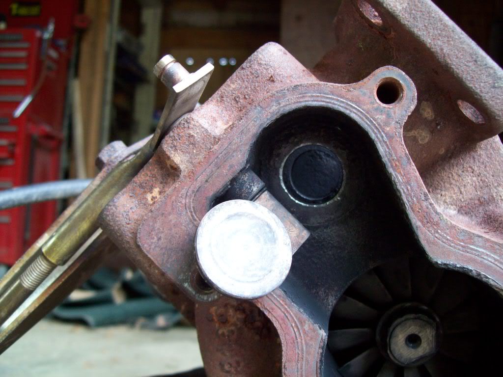

that gasket is reusable just clean it up some before putting it all back together.

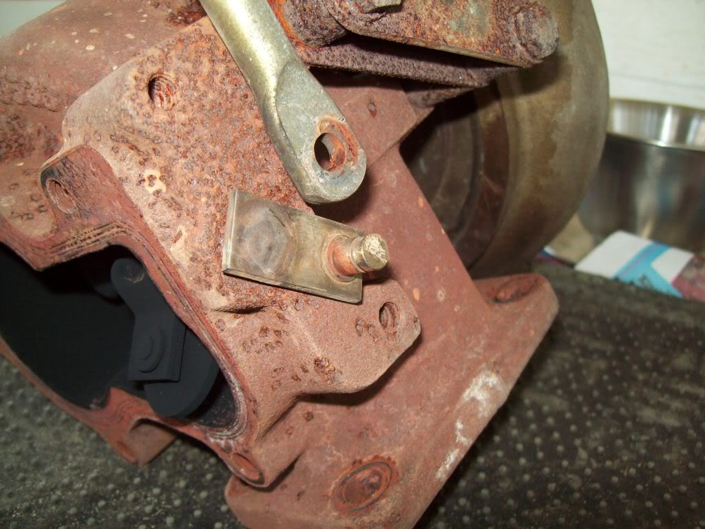

Disconnect the arm on wastegate using a small flat head screw driver on the Eclip.
once you have the wastegate disconnected you will be able to see the hole where you'll now drill out the flange.

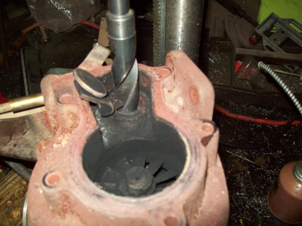

using a 3/4 drill bit on a drill press drill the divider flange out so both sides of the manifold can now be wastegated.
make sure you blow the turbo out really good with airhose and inspec everything on the turbo while you have it off for cracks etc. here the hole throu the flange
