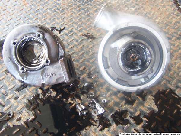

Nope, that's the HX35/40 that lasted 20 minutes and 2 miles! Only saw 40.6psi, but man was it spooling fast
Never take off you're twins that you made 402hp at 58psi and never even STARTED to clear up the smoke, and put on a Hybrid charger. That's what happens
Actually, that charger had to be a lemon the way it broke, but I sure didn't help it!
Now I remember the thread...
And what made you think that would be a great idea?
