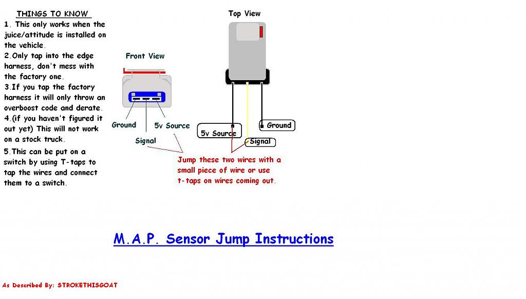

Originally Posted by CTD01
If you notice he DOES NOT HAVE THE COMP. He has the Juice with attitude. IT DOES NOT WORK! You will lose big power by just unplugging it.
Try it for yourself......
Attached Thumbnails Hot Juice Upgrade Worth it??-instructions-map-switch-jump.jpg
Old Oct 17, 2007 | 06:13 AM
91rangerturbo's Avatar
Posts: 839
From: Greenville, IN
will that work with trucks that don't have the edge juice?
