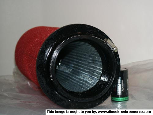

I have an afe stage 2 intake kit with the pro guard 7 filter, and love it.

I have an AFE kit on my truck, and the filter is red. At first glance I thought it was a K&N. I took it off while changing the oil yesterday and found oil/dirt on the intake of the compressor housing. When I held it up to the light I could see light through (both sides at once). Are the new pro 7 filtes better than the earlier AFE's.

YES, they are.

Shovelhead is right, get an intake or exhaust for what it allows the fueling boxes/programmers to do to make the overall mods perform at their best! While you will get a significant HP bost form either an intake or exhaust their real value is dropping EGT's so that you can use more of the fuel the electronics provide. I only reccomend the AFE Pro Guard 7 systems as they flow the air while they stop the dirt the 4 layer filters let thru. Be sure to make sure you specify PG7 on your price seaches and when you buy (if it's not from us as all we sell is PG7) as lot of sites are acting like you get PG7 when in actuality you get the 4 layer standard media. You woudl be amazed at the number of replacement filters we have sold because of this sales practice. Give us a call if you want we'll be glad to help you.
