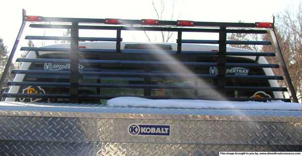

Ok found some batteries that still have life in them and got some pics. I had planned on doing gussets at the base as well, but once I got it all together I decided that it seems plenty strong...MUCH more so than the ranchhand ones I've seen, so I left them off for now. May put them in later after some stacks generate the room between the rack and toolbox. I'm also still toying with putting a gap in for the slider, but I'm gonna make the decision on that after I get the turn/tail lights and floodlights into the rack.
Attachment 21789
The ends are getting capped and once it's all done it's coming off and getting blasted and durabak'd.
Also, here is (as the Frenchman from the Matrix would say): Cause and Effect
Ed
