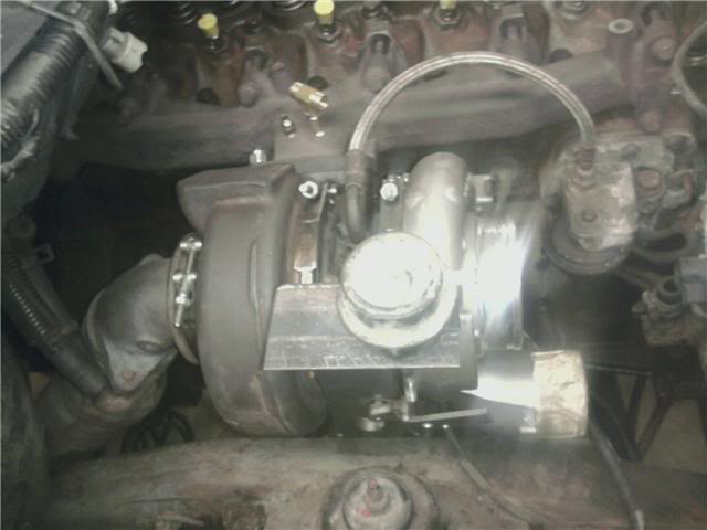

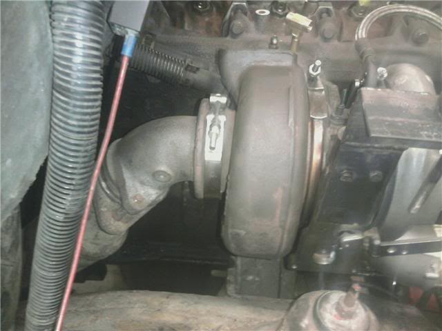

Here's mine, bolted to a stock 12v manifold with no adapter--plenty of shock tower clearance:

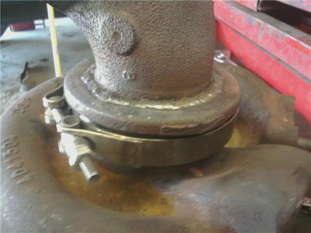

Had the oddball v-band welded to my hx35 elbow, so it bolts directly to my original downpipe:
Spring tension holds vanes closed untill drive pressure pushes the lever open. Hokey-looking cable setup it attached to a lever on the shifter. Pull back against the big spring and exhaust brake is functional. Not nearly as slick as the fleece setup, but I only got about 300 clams into the entire setup:
