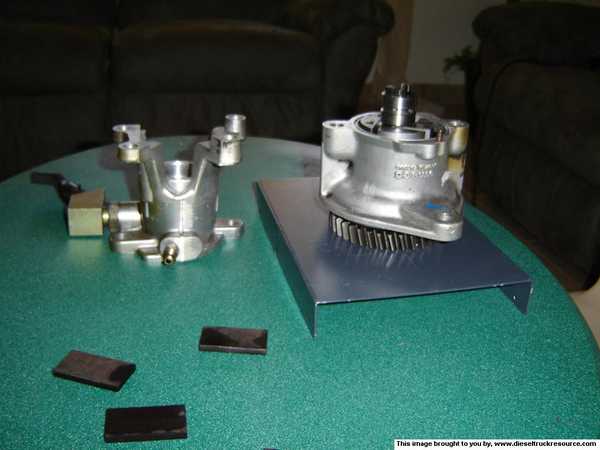

Here ya go buddy, here is the PS pump shaft :
And here's the vac pump shaft and gear :
They look more like interlocking shafts rather than a traditional press fit or tapered shafts.
im actually going to be mounting the pump directly to the engine. not to the vacuum pump. I need to know if the gear on the vacuum pump is a tapered shaft, with a key or a straight shaft? if anyone has one out I would like the measurements of the shaft diameter and keyway size. also the measurement from the mounting surface of the pump to the center point of the gear.
Whoops, wrong end . I believe it is pressed onto a tapered shaft. I do recall my pump having a "nose" on it if that helps any.
Looking further at the vendor that sold my reseal kit I don't see a keyway of any sort. http://www.fixinrams.com/Quickstart/...b/000_0096.jpg
You could probably ask Pete Gould at www.fixinrams.com . He's rebuilt a lot of these pumps and I bet he could get the measurements for you.
