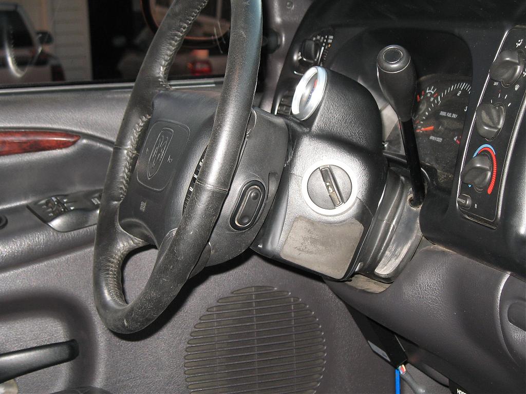

the ONE downside to the install was the autometer steering column gauge pod, it was the absolute worst thing i've bought from them, its currently being held on with electrical tape being wrapped around it and the lower stock piece....anyone know of a better one? gauge is 2 1/8"

Although FP is important it isn't something you need to look at all the time.
Mount the gauge on the lower dash ahead of the 4wd shifter.

Yea, today driving around I realized it blocks a lot of my view on the dash, can't see my wait to start light, so i have to peak around it, but I dont' really like the whole put a gauge out in the open look, althought I might resort to it, I've seen some double pods that mount either to the dash or under the dash, I don't really know of a 5th gauge I'd need.....
