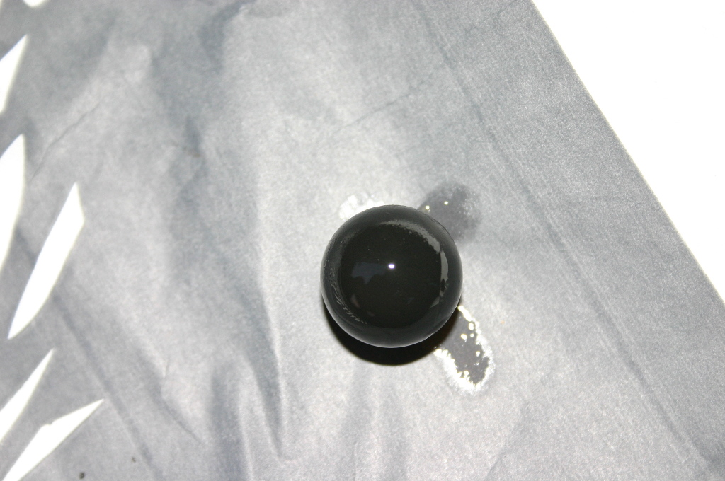

I have the old motor. Found it easiest to take the bracket loose from the frame, then I could see the top of the pump, and what might fall out, and the dirt that can get in, when I pulled it apart. This allowed me to clean it off before pulling it apart also.
The ball looks like a little black rubber ball, and seems concentric. The O-rings look fine.

You need the 5/8" Ball update.......that there is the 3/4" ball. They had issue of sticking under the T-block. This would cause the pump to hesitate to build pressure until the check ball is reseated. BUT would not cause the unit to loose prime per say. Its just by-passing the pump. Contact a dealer for the ball.
PN of the 5/8" Buna Ball: 1901-625-5939
