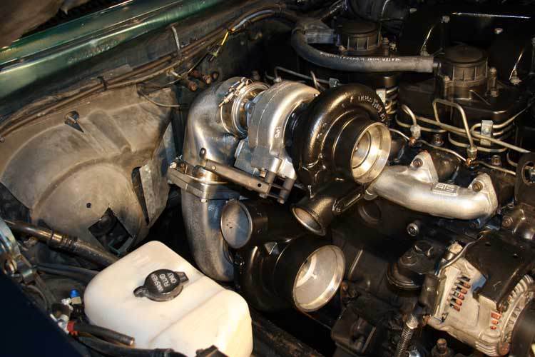

If one reads the fine print of most of the common header wrap seen in Summit or Jegs, you'll notice a disclaimer about the headers rusting out VERY early for example. Iron, steel, etc, corrode at a higher rate at elevated temperatures. Most metals also become weaker at elevated temperatures (see a lot of fine print).
When installing the twins on my heap, I went ahead and had all the hot stuff silver-coated to keep as much heat in the exhaust gases as possible. On the flip-side, I painted all the cold-piping satin black so as to help Dump heat from there (Colors like white and silver tend to reflect heat like a mirror whereas dark colors like black tend pass heat such as is seen on a solar panel or a heat-sink on a high power stereo).

The downside is that the plumbing will run hotter than that not insulated. If the plumbing components aren't able to withstand the typical loading at an elevated temperature, then early failure can occur.
