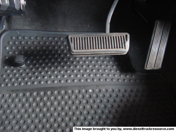

yup, it can be done for about $10-15. do a search for "mystery switch" or "lockup switch". i used a dimmer switch to control mine

IMO a lock up switch is the only way to go. It can be done for about $10-$15 depending on how fancy of a switch you want. Once the tranny hits 3rd just flip the switch and it will stay locked no matter what. Just remember to unlock your converter when you come to stop because the converter WILL stay locked and the truck will just keep on goin. It also makes a funny noise too
