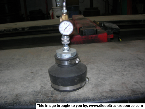

Pretty simple to make with a few plumbing fittings from Home Depot. You can get complicated with it or keep it simple, they all work the same. Pressure it up and soap spray away.
This is what I use......
Jeff

Here's mine. Same idea.

I posted a thread a few years ago on TDR about building this contraption using the fernco & pvc cap. I just thought it up one day when I was standing in my garage trying to find a boost leak. I never heard of or read about anyone building one like this before I built mine. I think of it as my personal design, maybe someone built one before me, who knows. I built mine from my own mind & named it my "Redneck leaker seaker". I've searched posts before my post on TDR & there was no info about it previous to my thread.

Originally Posted by Homestead
That looks a lot like mine. I used a valve stem on the pvc cap and use the guage already on the tire chuck.
