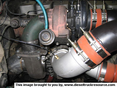

thats what i'm running. i can't remember any specifics, but it's just a bit smaller all the way around (turbine, shaft, compressor, housings). spools great just doesn't flow quite as much. does it have a divided turbine housing? if so, it's probably a 22cm. the compressor outlet set up is nice though. you can get an elbow like the ones we already have, just bigger.
like this:
there are more pics of the turbo in my gallery sitting next to my h1c w/12cm housing.
