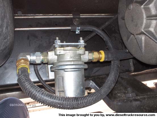

yup same here did mine about 3-4feet away from the tank right under the transfer case skid plate idle, is 15-16psi WOT 13-14psi plus if need be I can change the LP easy

Joe Diesel, thanks for the photo. Which pump is that?

It is some kind of special deal for those running an in-tank lift pump. The picture JoeDiesel posted is the "normal" lift pump that has been relocated by the vulcan kit.
That was my guess on the pump photo.
