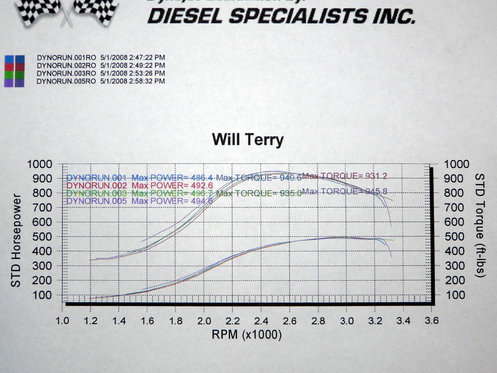

I was scared for old Blue when that hot 3rd gener put down such low numbers, but she pulled through, here's the graphs. First pic has a little smoothing and all four runs.

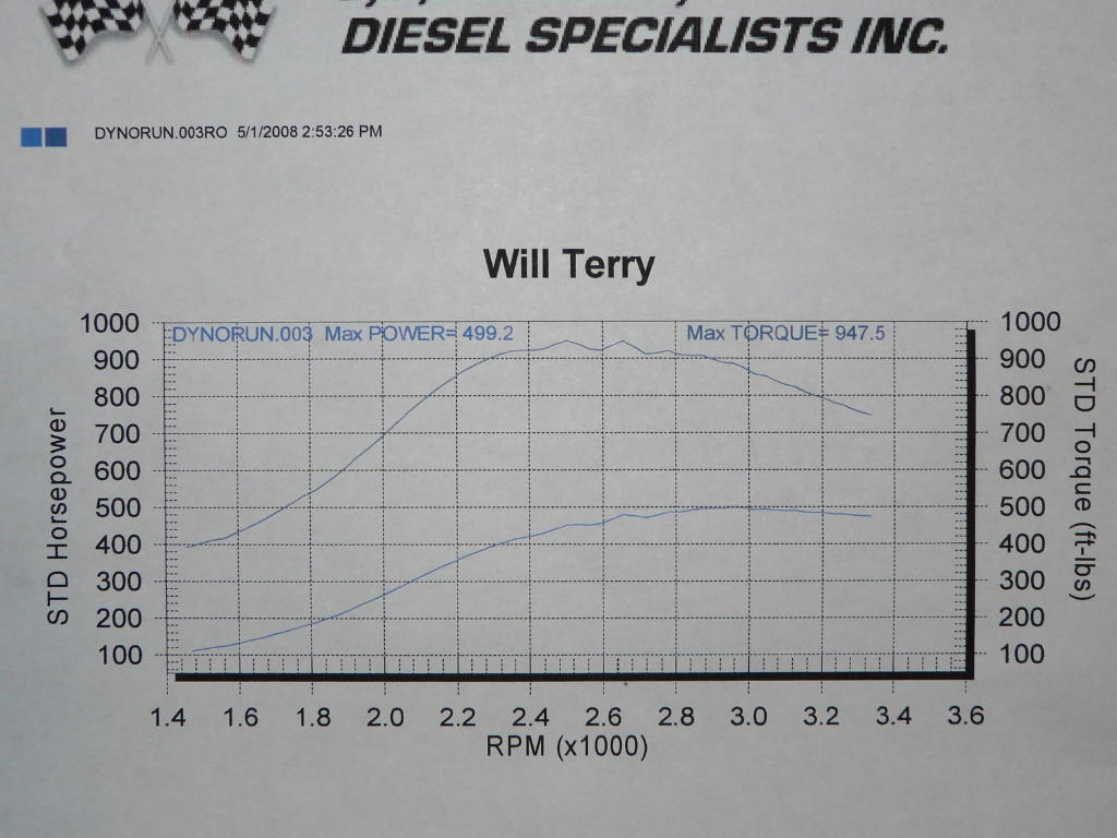

Second pic is of third run, highest HP, with no smoothing. There is no correction factor either. Las Vegas, Dry Humidity, 75*F kind of chilly for Vegas this time of year, and about 2200 ft elevation. So if anyone wants to semi correct my numbers so I can join the "club", that would be great.

I forgot my usb cable so I was only able to dyno Adrenaline AGR 2000 tune.
Run 1 PL 10
Run 2 PL 8
Run 3 PL 7
Run 4 didnt start recorder till midway through the pull so it was deleted by them
Run 5 PL 7 with clamps on the wastegate tube trying to get more than 40 PSI boost but no change. I wonder if she wasn't heat soaked or at least had a big fan blowing if it would have broken that elusive 500 HP.
No one is gonna give me that last 0.8 HP for the spike are they?
Does anyone think my clutch slipped a bit? I was beating on it and might have glazed it a bit. Las Vegas is 2500 feet lower in elevation than my current residence and the super fast spoolup and instant power was too much to resist!

Those are killer numbers-- but I'm surprised you didn't break 1K torque anywhere
It looks like the Adrenaline pulls well into the upper RPMs, and that's why you can make the bigger power without the typically monstrous tq numbers. It used to be (back when we were RPM handicapped) that most guys over 450hp were over 1K lb-ft or close to it.
Dare I ask what the EGTs were?
Was this a DynoJet? It looks simlar to the Superflow printout I once had...
Anyway, it appears that the 3rd gen turbo is working very well for you.

I didn't get corrected numbers, but I wonder if my clutch was a little glazed over as there are two spikes/slips right about where the torque peaks out.

Quad, if you check Comp D, those guys are leary of the validity of my dyno run because the power curves are so smooth!

Those are great numbers indeed. PL07 was still pulling strong at the end of the graph.

Thanks J Lent. The dyno operator told me he usually just runs them out to the rev limiter. Luckily I asked before he did a run so I could inform him of the Adrenaline's high rpm capabilities and my stock valve train. I told him to run it out to 3500 rpm, but he was a little quick to lift as you can tell by the runs.
