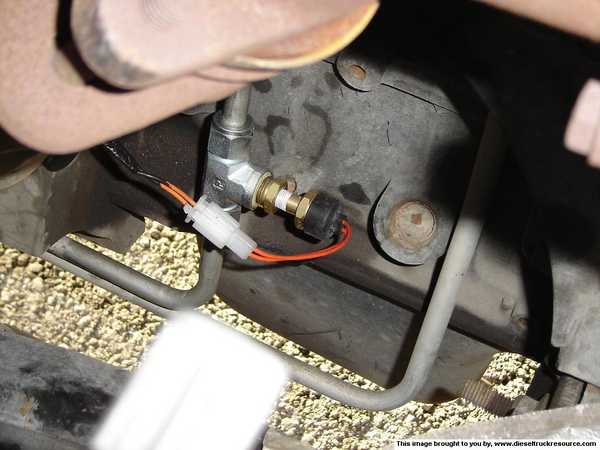

I second that motion. With the sensor in the pan, you are measuring (generally) the coolest temperatures in the tranny system. The output of the tranny coolers drain into the pan.
Now with the sensor in the hot line you are measuring the (typically) hottest fluid in the system, since the tranny has just used it and is sending it up for cooling. If your coolers are operating well, your tranny could be putting out 200º+ fluid while your pan sensor may only see 150º. IMHO the hot line sensor is the way to go. Better to see the temperature spike and be able to pull over and cool the tranny, than to burn up clutch packs (and other heat sensative things) because your pan sensor didn't catch it in time.
BTW, as mentioned earlier, Geno's sells the fitting to modify an existing line. Also Diesel Manor sells the complete line with the fittings already on it, just another option there. I went with the Diesel Manor line, since I bought my gauge kit there too.
Heres a picture of what the sensor in the line will look like :
