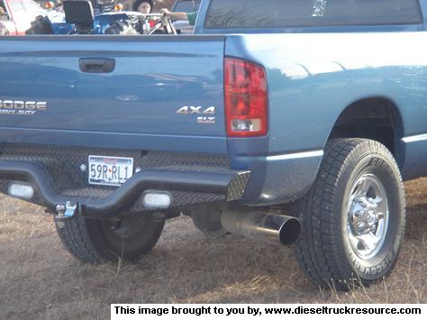

Bumpers:
A shop near me, made a huge bender, to specificaly make bumpers like in the pic, but broke parts of the bender on the first try, they did not make it with a mandrel, actually i knew it wouldnt work, cuz of the 4" tube deforming ...
any ideas?
