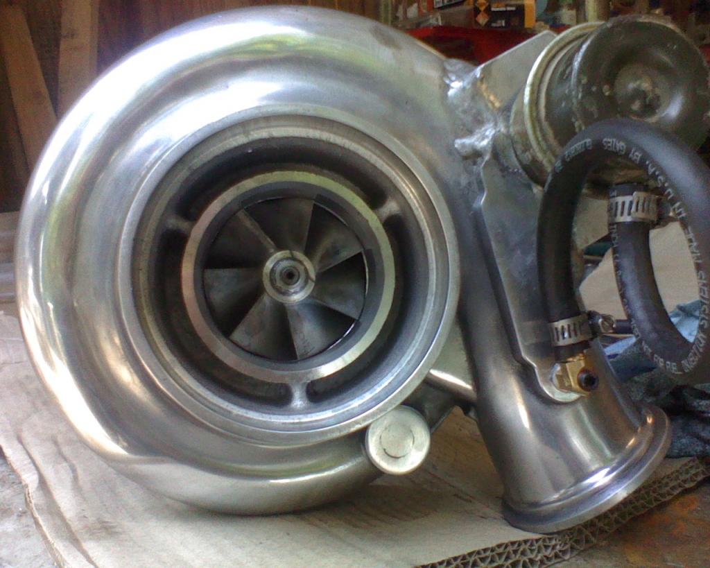

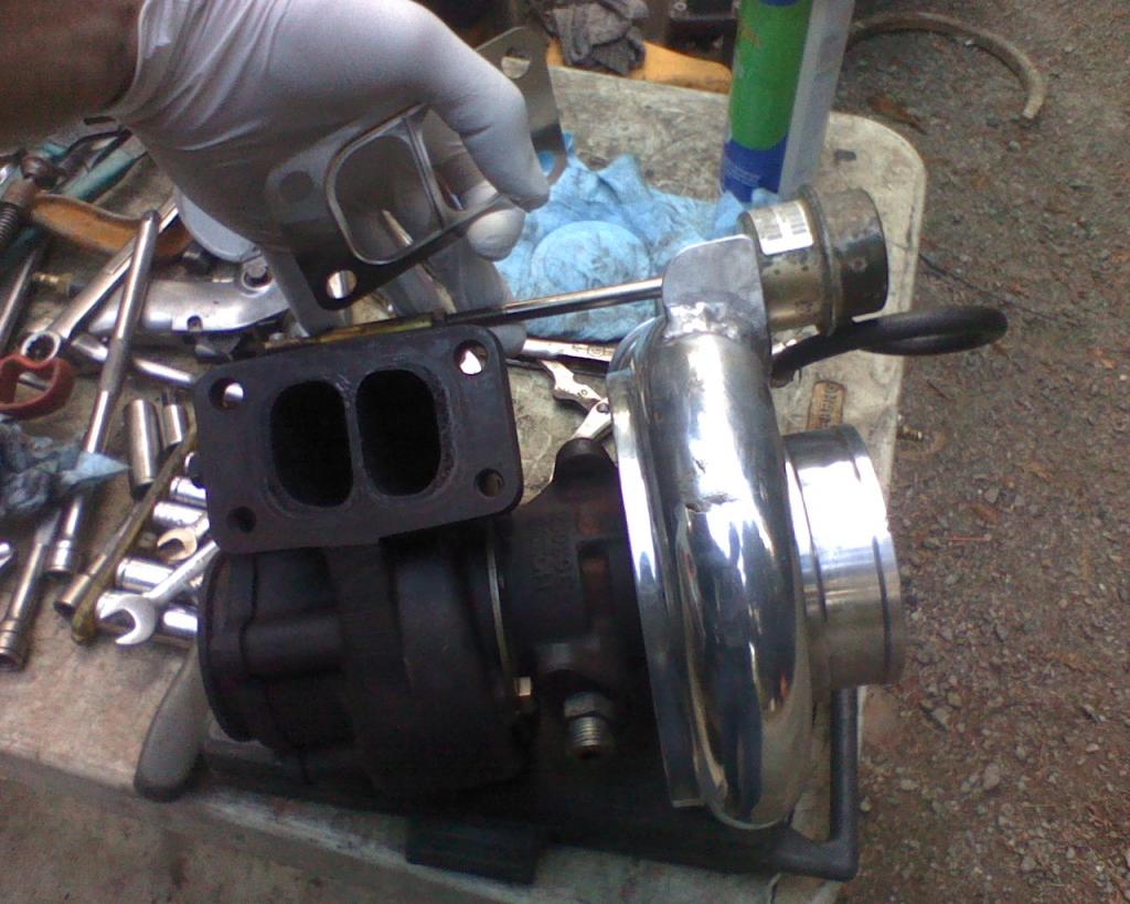

I realize this thread is ancient, but on a search it seemed the best place to put it. I just did the 35/40 turbo from my OE HX35.
The biggest hitch is that most hx40 compressor housings do not have a provision for the waste gate actuator, and the smallish housing size of the 35 is a benefit for quick spool, but the waste gate controls drive pressure. Sealing it off is very very dumm- *especially* with a hybrid since drive pressures become more of an issue with the increase in flow.
I cut the center housing recess (mill/rotary table) to accommodate the larger diameter wheel. There are a handful of different diameters, so stating a size is useless. I went .050" larger diameter (.025" clearance at edge) than the new wheel.
For the waste gate actuator, I used 3" aluminum C-channel, and TIG welded it on after punching the slot and holes. Only to find that the slightly larger housing made the actuator interfere with the oil filter. So I had to mill the actuator rod slot deeper and cut the mount holes into slots.
But here's another surprise: The actuator pot interfered with the ID plate casting, so I had to machine a pocket for the actuator to tuck in out of the way.
The actuator rod will almost certainly not be adjusted correctly once you do all this. The female end has a stake to prevent adjustment. Drill it *just* so the threads are released. Then use a jam nut. Once assembled for test fit, adjusted rod to slip snugly over the WG lever, then tightened 4 turns. I repeatedly read 3 turns, but had poor performance which improved markedly with an extra turn.
I recommend *against* setting your pressure solely using the actuator rod as an adjuster since it cuts down on WG travel. A run of the mill "boost elbow" is the best way, but minor adjustments from there are fine. I'm running an adjustable boost elbow, but plan on putting the non-adjustable back in and using the rod to fine tune +5psi for 35psi at the manifold.
I used a BAE 60mm/86mm turbo wheel/housing that cost $280 taxed and shipped, and a HX35 rebuild kit off e-bay (turbopartscity02) for $36. So I'm into it for about $350 and two days of work. But that includes doing all the manifold gaskets too, and at a slacker pace.
http://baeturbosystems.com/compresso...2-2-1-2-3.aspx

Edit: add second pic. Note how the actuator goes into the ID plate. I'm not the swiftest at TIG unfortunately, but it's functional.
BTW going bigger has drawbacks. You gain upper end performance at the expense of low end performance and response. More than you might think. One design bends this rule: Ball bearing turbos, which the Super B is, I believe.
This hybrid setup *is* laggier- instead of the puff and go, it's billowing black transitioning to grey, followed by a much harder push in the pants. I'm fueling somewhere between 400 and 450 hp though. That's with a low rpm abrupt stuff of the throttle though.

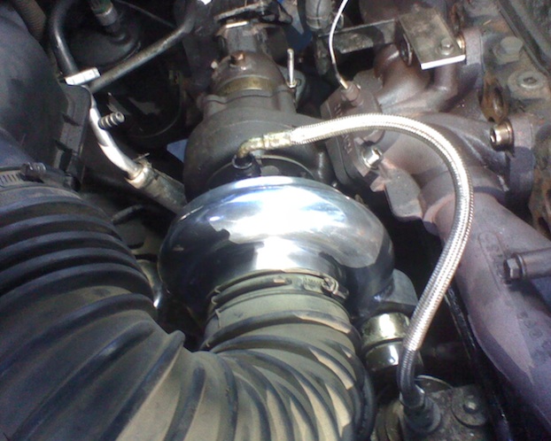

This is my first time posting a pic,
I'll add another.
A *perk* I hadn't considered is that the lag is a benefit as the turbo stays spooled enough between shifts (if I'm quick) so I don't smoke as bad between shifts leaving a light. With the stock turbo I REALLY had to be spooled and shifting quick to not smoke between shifts. Either that or drive like a slug.
One of the reasons I did this was that I tend to bog along at low rpm for efficiency and occasionally found myself being followed by torches and pitchforks. So I wanted to have better flow at low rpm without going to a yet smaller exhaust housing- I'm sure a hy35 would have cleaned it up too. Cake and eat it to syndrome. Keeping my full closure turbo mount brake was also non-negotiable, and the expense would be hard to justify for replacing a perfectly good hx35.
My hope is that this mod won't hurt my fuel efficiency, and perhaps help a little- but my guess is that it will depend significantly on driving style, which won't show up until the glee factor wears off.
I'll add another.
