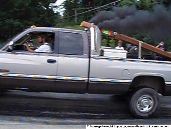

FYI-
This is a full forward #100 plate while waiting for the turbo to spool. Truck also has a 4KGSK.
