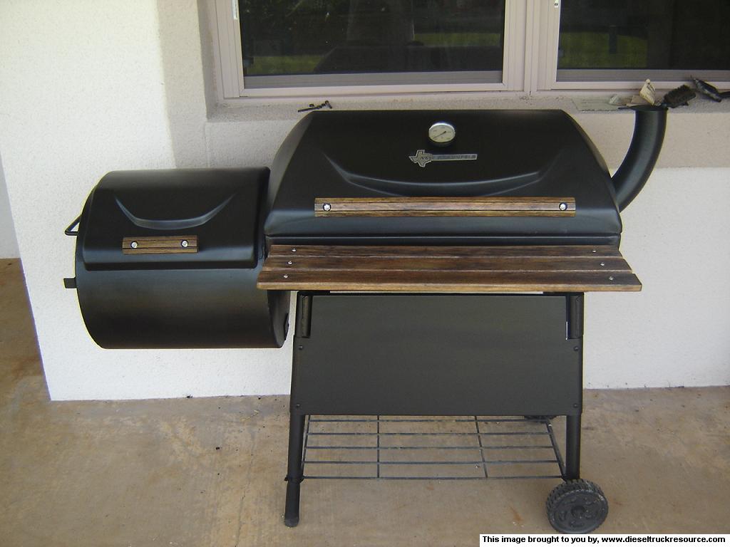

Got it put back together
I finally finished the grill. It took me several days to do the wood. I sanded it, cleaned it up, and then varnished it. After the varnish set and dried I sprayed some clear poly-urethane on the pieces to further protect them from the elements.
All of the bolts got replaced with stainless steel hardware. Every bolt, nut, and washer. I even put hi temperature anti-seize on them. I am very pleased with how great this thing turned out. Check it out:
I have it running right now with some charcoal and hickory wood. I am smoking a beef bottom round roast.

In order to give you an accurate reply as to what I think of your project, you need to send me 10 lbs of smoked ribs.....Don't forget the extra sauce

Too bad you couldn't take it to the corrosion control shop on base and have it powder coated !! I wonder how that would hold up to the heat. That stuff is awesome for corrosion !!

At my company we do powder coating, and it will withstand all the heat you can throw at it. It's MUCH thicker than paint, and a lot more resistant to flaking too. It's a bit heavier though, and your tolerances get tigher when you use it in tight spaces, but it works great and has a very good finish. It's also a bit more forgiving to work with than paint, and will hold up longer, whereas paint will stand up best with a primer/ground, then a color coat, and finally some clear. Our powder coated parts last a lot longer.... As a durability test we made a part with paint and clear, then an identical part with powdercoat, then proceeded to drive over the parts, throw them into the street, skim them along concrete, step on them and mash them into the ground, and finally spin the tires of an automobile on them.... The powder coat was much stronger and a lot more resiliant to cracking and peeling in large chunks. The only problem is finding a large enough oven to bake huge parts in..... That's what limits our powder coating production...
