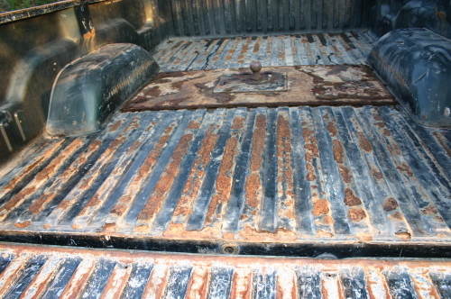

I pulled the bed liner out of the farm truck (the 96) tonight. The bed ribs are rusted pretty good. I'm not finding it all that abnormal since it used to belong to a landscaping company, and they cut a hole in the bed liner for the GN, then all kinds of dirt, etc. got though the hole and was trapped between the liner and the bed.I pressure washed it and found that while there is rust, there are no rust holes in the bed yet.
I'm trying not to put too much money in this truck as it was bought to be a beater, and if I make it too nice I won't use it as it was intended. I know I could just leave it alone, but I can't help not wanting it to get any worse.
My questions:
1. If you seal up a rusted surface, not flaky rust, but surface rust, will that stop the rust from continuing?
2. If I put a spray-in bed liner, will that keep the rust from continuing? (It is my understanding that the spray-on company just scuffs the surface, they do not sandblast it)
I know that if I can spray it down with oil that will stop the rust in its tracks, but I will have to reapply it every so often.

What I am trying to slow down/stop:
I'll check at Napa today for the POR stuff. Will Naval Jelly do anything?

Yes Naval Jelly's chief component is Phosphoric acid. It may not give you the smoothest of results on the finish coat though and it is not made to be left on like the Ospho/Prep and Primer is.
The Prep and Primer chemically changes rust to an inert substance called Iron phosphate. When topcoated with a roll on bedliner product you should have no more rust problems.
Have you checked the underside of the bed?
Rick
